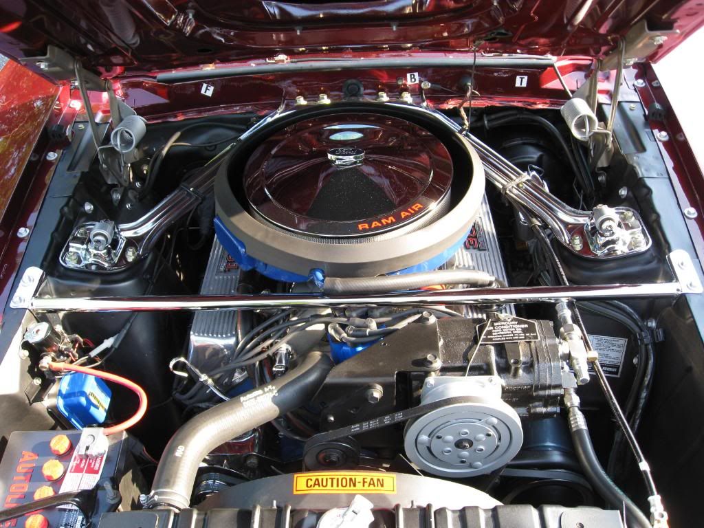

Here's a couple of shots of the Trick Flow 195 Port Port CNC ported heads I am running. They are considered a 2V style head and IMO are perfect for street use.

This was the first engine, before the 408C stroker, but you get the idea...
