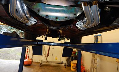

Hey 207, here is my FPA headers on my 351C 4V 70 eliminator. They are about flush with front subframe rails and the trans pan, they are hooked up to 2.5 inch stainless steel magna flow exhaust system.
