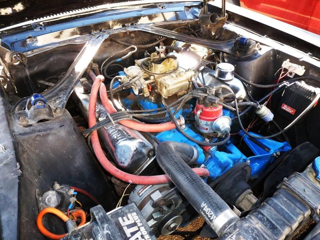

Almost ready to test fire the GT after many months of work. This is last fall...
And this is today...
Many sincere thanks to everyone on this wonderful forum who has assisted me with expert and patient advice while I have stumbled through.
Cheers all!
Dennis

What engine color did you use? Did you rattle can it or use a gun?
1970 XR7 351w 2v White w/ Dark Tobbaco interior
User avatar
anthem75
Registered Member
Posts: 236
Joined: 24 Nov 2015, 20:19
Re: Countdown...
#6
Post by anthem75 » 17 Jul 2017, 10:00
Rattle can...I forget the actual code, but it is called "Chrysler Low Gloss Black". Was recommended by a mechanic buddy of mine. Pretty pleased with the results.

Post by xr7g428 » 17 Jul 2017, 10:01
Wait and see if it is an issue, but you may have a miss at idle from the cylinder here the PCV line is connected. It may run too lean at idle on that one cylinder. The line that splits the PCV between the two banks running to one of he cylinders on the opposite bank is the cure if you have the miss. Sometimes you will sometimes you won't...

Post by anthem75 » 17 Jul 2017, 10:05
Here's a better shot of it before the engine went in...

xr7g428 wrote:
17 Jul 2017, 10:01
So the exact way it is currently set up is the PCV and brake booster are together on the rear manifold vacuum port, and the tilt-away wheel and hide-away headlights are tied together on the front manifold port.
