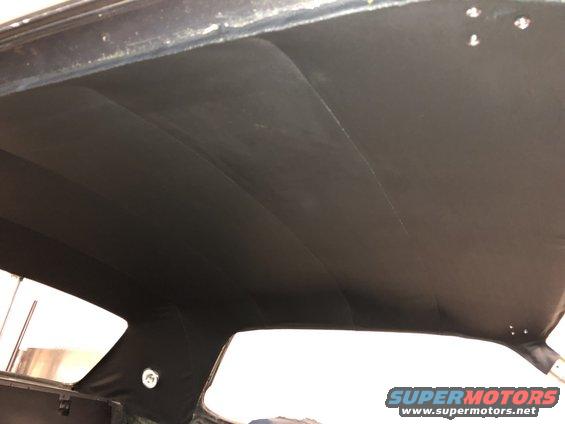

Post by DieselD » 24 Feb 2019, 15:04
Slowly but surely making a little progress. I’m only getting about 2-4hrs a weekend on her so I plan out what I think I can get done in that time so I can make the most of the time I get.
here are a few progress pictures
Windshield and trim
The rear glass is in but still need polish all the trim and seal it in. I did find quite a few scratches on the original glass when I cleaned it up so that’s a bummer but with the cost of the repro I’ll deal until I can find a nice original
Decided to run some led bulbs for the under dash lights and opera lights. I do not care for the cool white variety that WCCC sells so I sourced some natural white bulbs from M4products. I used the elite series(brightest) for the opera lights. Happy with the results and they bring a nice white light rather then the cool white. I run all their bulbs in my toyhauler with great results. http://www.m4products.com/single-contact-round-bases/
As more parts go in I’m making small adjustments to the headliner to take the wrinkles out of the rear sections. The alum strips in the package tray area helped a ton.
